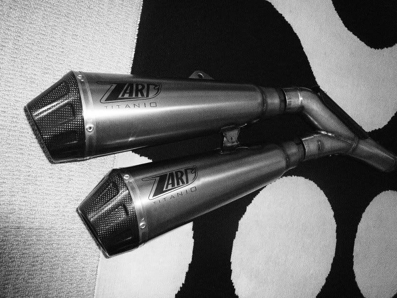

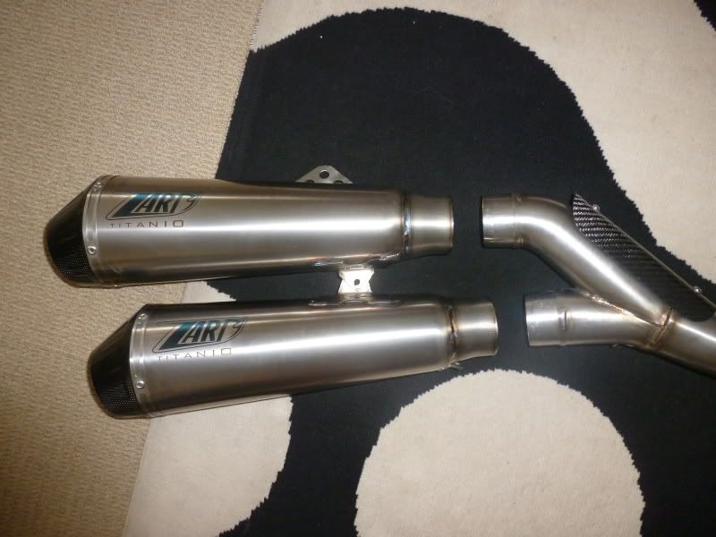

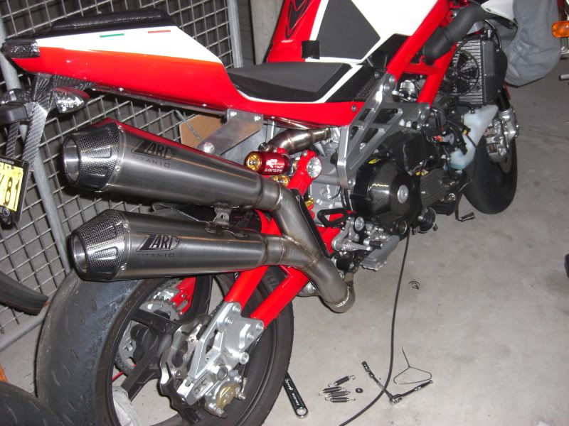

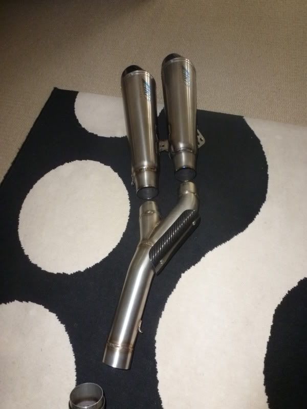

Here are some pics of the Zard full system, must say this looks awesome in the flesh. I'm guessing the headers and collectors are fatter than the original system, I'll check all that when I get the install underway.
Enjoy!
Looks like the carbon heelguard will sit over the swingarm, so I can take off the double layer of red gaffer tape where my heel rubs.....
getting carried away with the arty shots
I'll chuck up the install pics as they happen. |

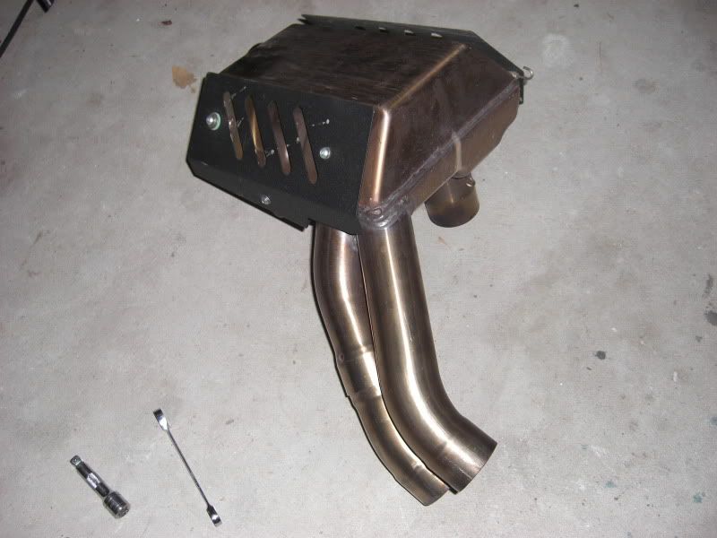

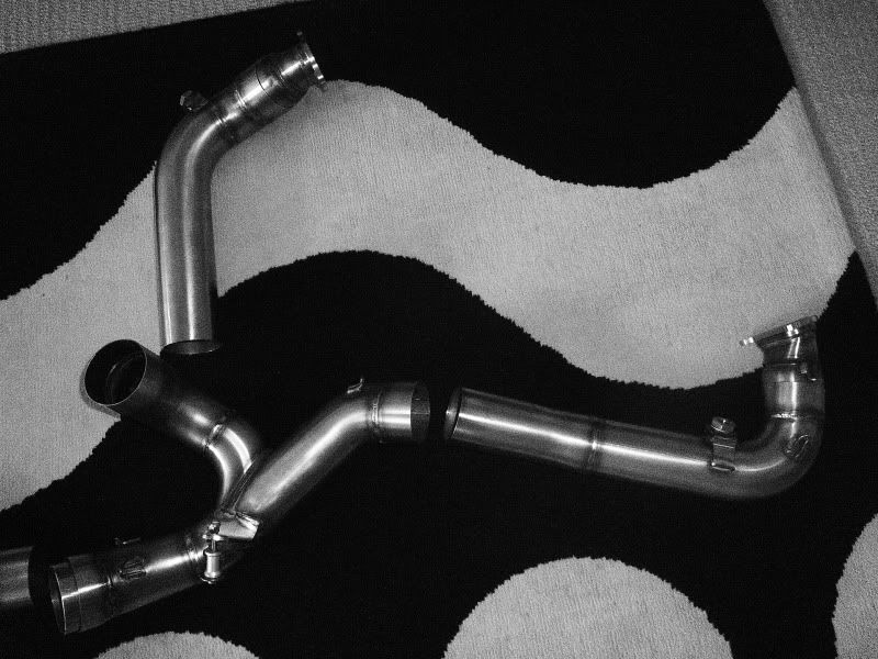

here we go, a few pics during removal:
looks a bit MotoGP, if you screw your eyes up a bit...
steampunk jellyfish? Hmmm, maybe not. Ugly lardbucket CAT? Oh yes.

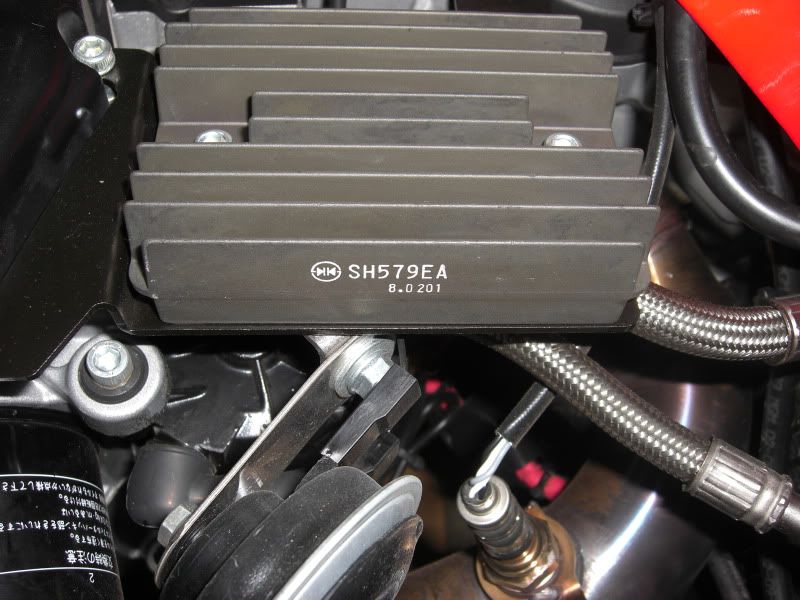

Disappointing, was hoping to see the newer MOSFET type reg/rec. on a bike of this calibre. Oh well, preventative swap added to the list of things to do. |

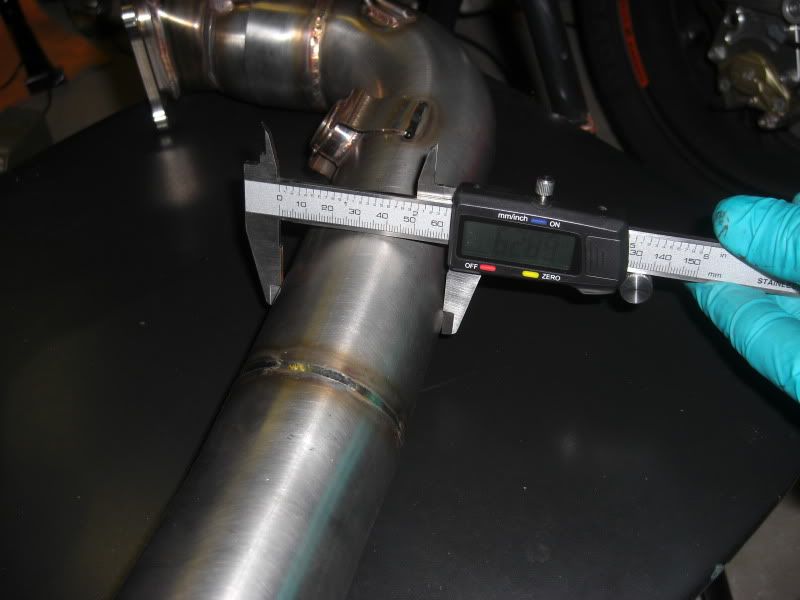

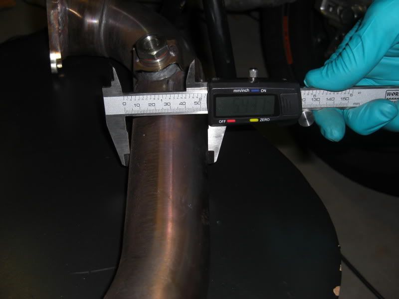

55mm dia. stock header
vs 63mm dia. titanium header
ta-da!

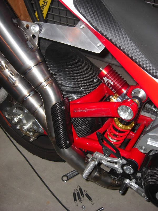

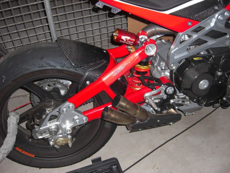

Went on fairly easily although the spacers supplied by Zard for the 3rd mount pulled the outer pipe tight against the swingarm; had to turn another set to get the inner and outer clearances right. With the oil cooler out of teh way the header nuts were pretty easy to get to.
I just added some CF sheet wrapped around the swingarm to protect against heel marks (the scuffs in the pic above are on the helicopter tape I bodged on there in a hurry, the swingarm cleaned up OK).
Bob at Bimota Spirit is helping me out with the diagnostic software, so with any luck I'll get some dyno runs in prior to PI in November. In the meantime I'll swap out that reg/rec with an FH012 and replace the OE loom connectors. |

Hi Mark, Can you just swap over rectifiers like that? Are they specific to a model? I beleive i need a new one on my DB7 but dont really know what i need to get. Ive been having trouble with keeping charge in the battery and starting the bike, been led to beleive that its the rectifier.
Any ideas?
Perhaps if you want to sell me your old one when you replace yours with better one  _________________ My worry is when i die, my wife will sell my stuff for the price I told her i paid for it. |

Hi mv05 - reg/recs aren't model specific as such, but they do need to work with the alternator output; smaller/older bikes can output approx 300 Watts whilst more modern/bigger bikes tend to push out upward of 450. From memory the FH012 reg/recs will handle 50amps which is sufficent for the higher power output of the 1098/1198engine.
I've had reg/rec trouble on many bikes over the years including Hondas, so have swapped to the new FH mosfet reg/recs on all my current rides. (2 x Triumphs and Ducati 748). Triumph have just done a big warranty replacement programme for the D675 and Street Triple in the US where they straight swap to the newer Mosfet type.
The FH012 is used on the latest R1 and CBR1000RR, and that is what I will be swapping to - but you do need the right loom connectors for this type, i.e.
http://www.easternbeaver.com/Main/Elec__Products/Connectors/R_R_Connectors/r_r_connectors.html
Jim also does wiring kits for these reg/recs, or you can get a similar kit incl. the reg/rec from the link below:
http://www.ebay.com.au/itm/380473042169?ssPageName=STRK:MEWAX:IT&_trksid=p3984.m1438.l2649
Background reading on the Triumph issues (credit to Triumph675.net and 'd'ecosse'):
http://www.triumph675.net/forum/showthread.php?t=35227
Hopefully these links should give you the info you need, one other handy link is UK based (I still get stuff posted over here from them) - Vehicle Wiring Products - they do the Tyco weather sealed connectors (amongst other things) used by Ducati and Bimota:
http://www.vehicle-wiring-products.eu/VWP-onlinestore/connectors/multiconnectors.php
Having said that these only work for the thinner gauge wires, so stick with the MetriPack 10-12 AWG connectors for the reg/rec upgrade.
I'd also advise that you solder your terminals after crimping as you dont want these connections to melt due to a poor connection. |
