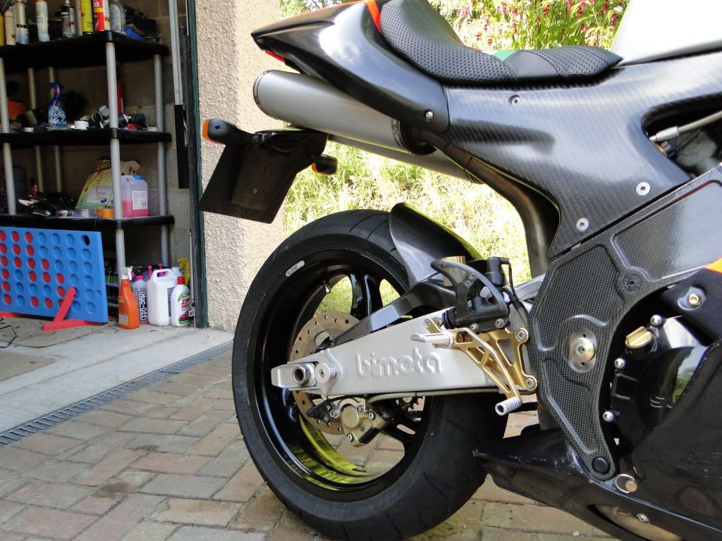

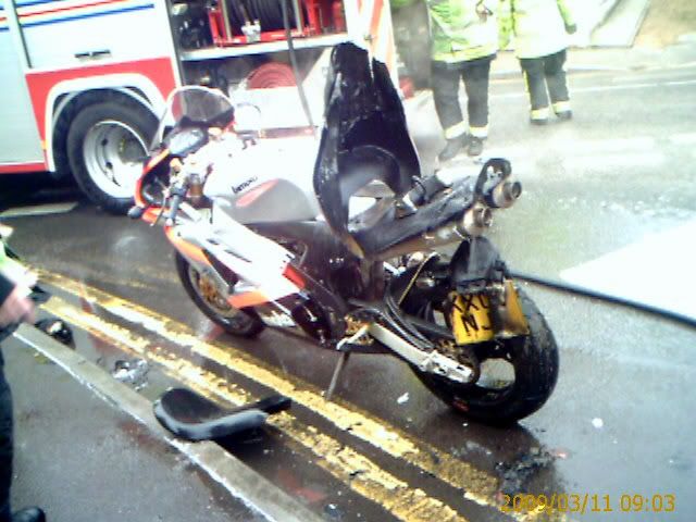

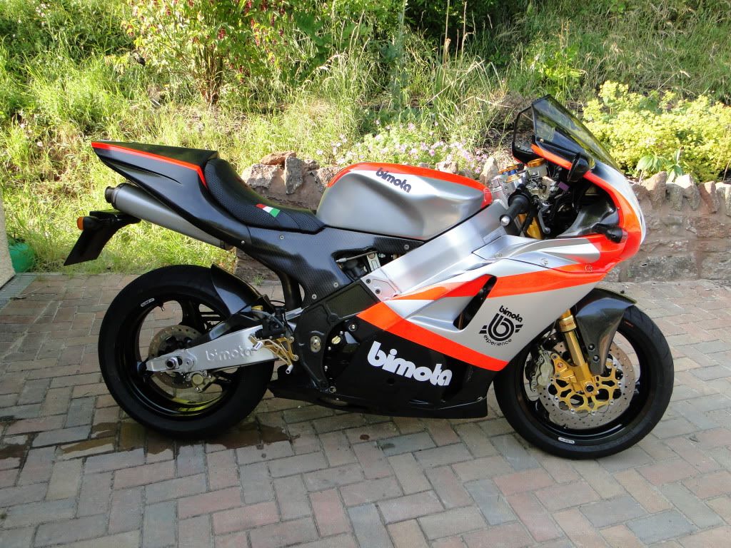

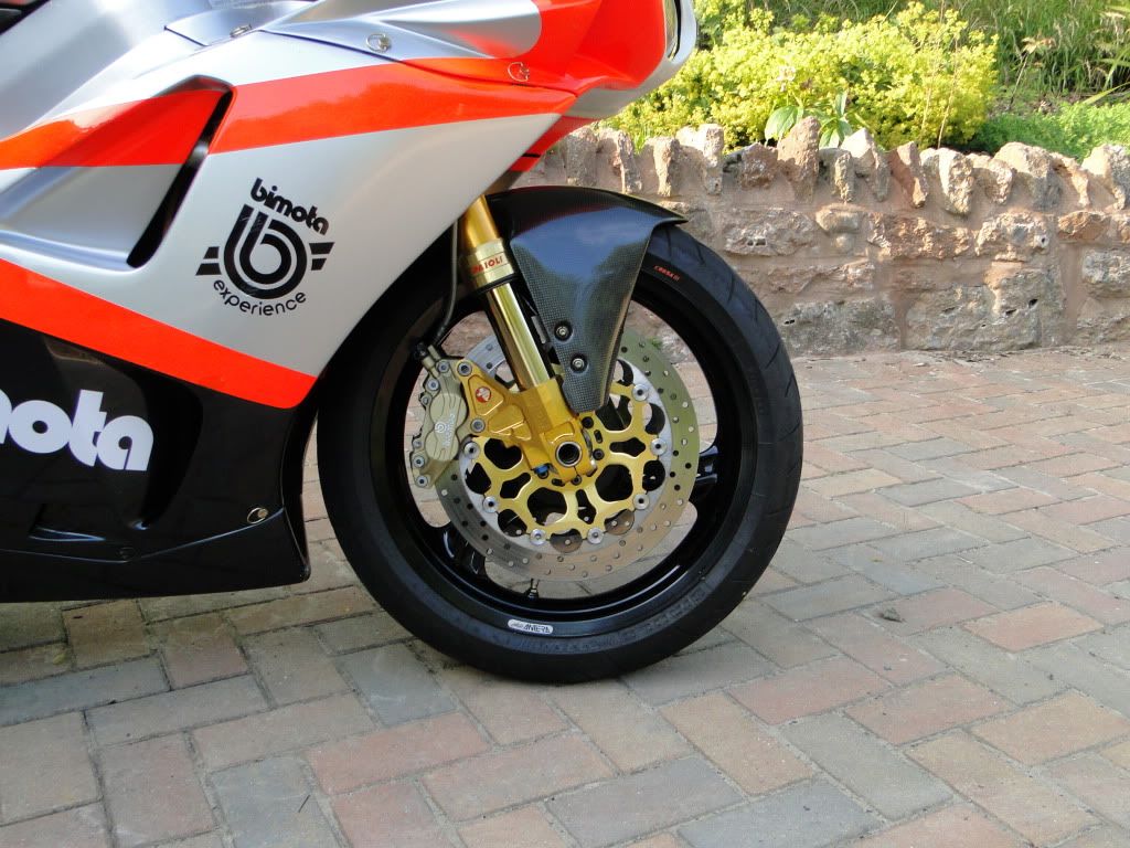

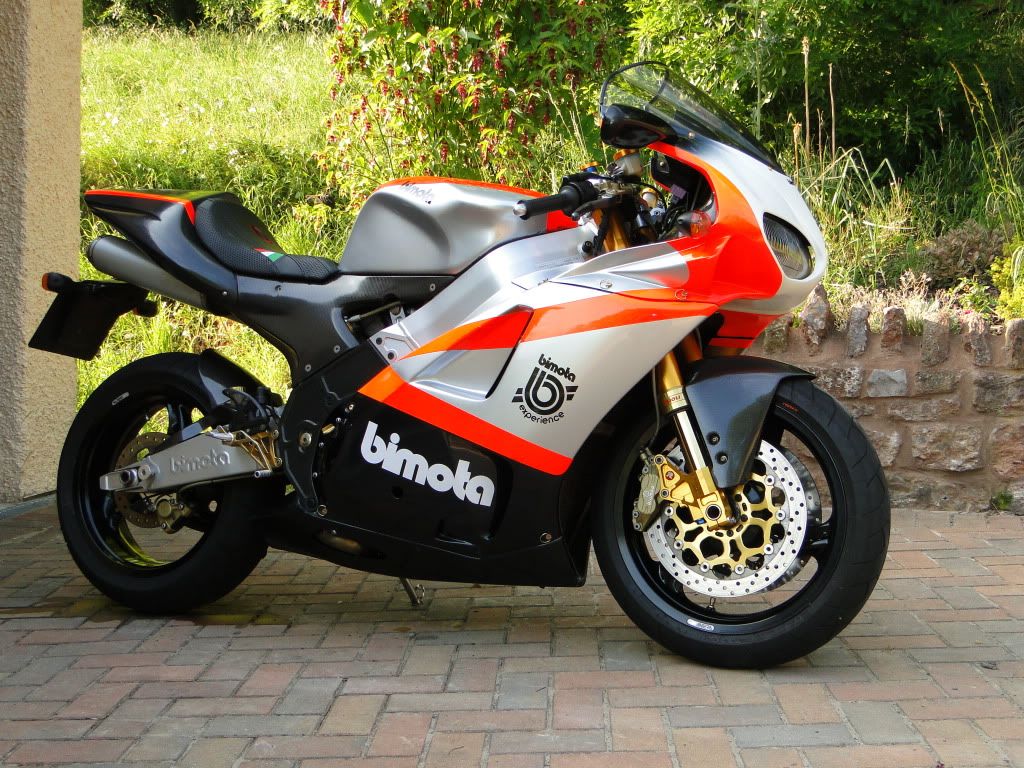

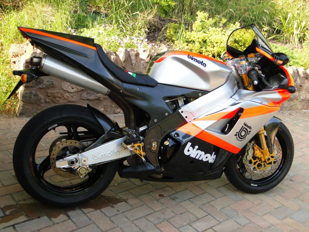

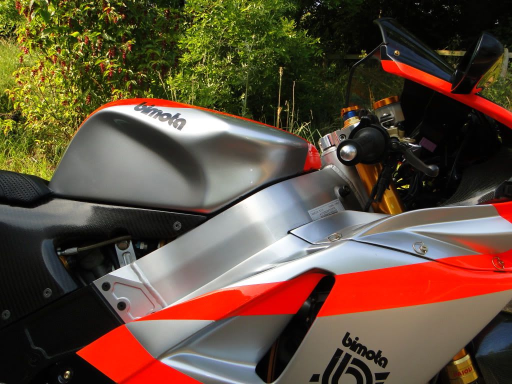

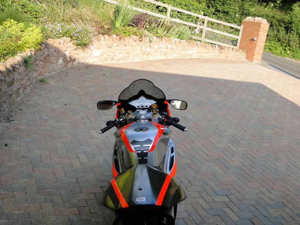

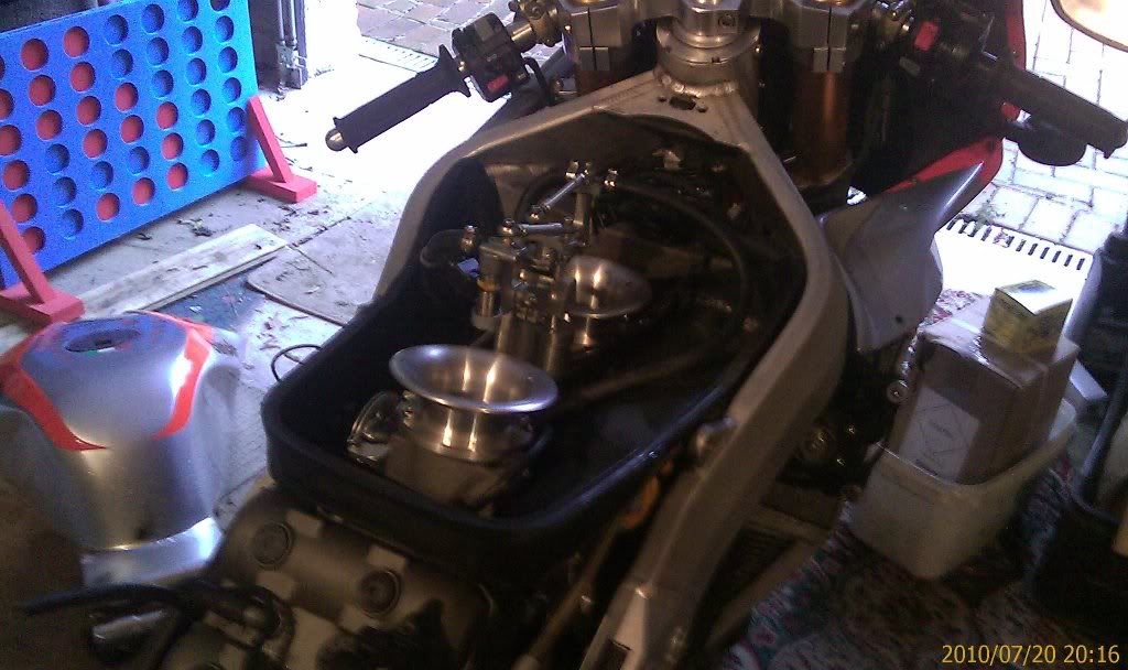

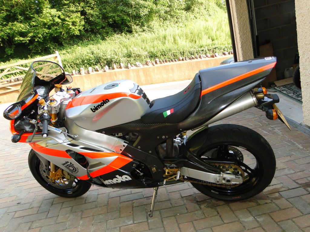

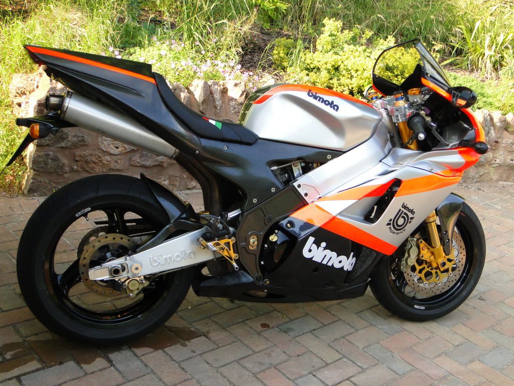

Here are a few pictures of my bimota SB8K Gobert. As you might recall it has been rebuilt after a fire caused by a fault (piece of very fine aluminium swarf in the petrol line lodged in the injector) leading to the bosch injector staying open.
The bike has radial (servo controlled and articulated) shower injectors, carbon air box, carbon body work, partially carbon frame, carbon fairings and ancillaries, carbon seat support, magnesium engine casing.
The bike was dynoed at 130 at the back wheel shortly after I put it back together.
But after a couple of months riding I adjusted the TPS (richer) and the bike got another lease of power marked by a broken chain 5 miles down the road.
The tool for TPS setting of the SB8K is about as easy to find as the holy grail, so I was happy that I'd gotten so near to full power for this bike after the rebuild without having to spend months trying to track down the £1000 device (which might not even work when you did get it).
On the Gobert, the seat fairing is normally painted white with a 501 on it, but rather than wait for a respray, I rubbed down and polished up the carbon and added some vinyl striping as a trial, it doesn't look out of place so I have left it.
Took the pix about a month ago after getting rid of a few thousand miles of summer riding. Hope you guys enjoy looking at these pix of Gobert as much as I do.
