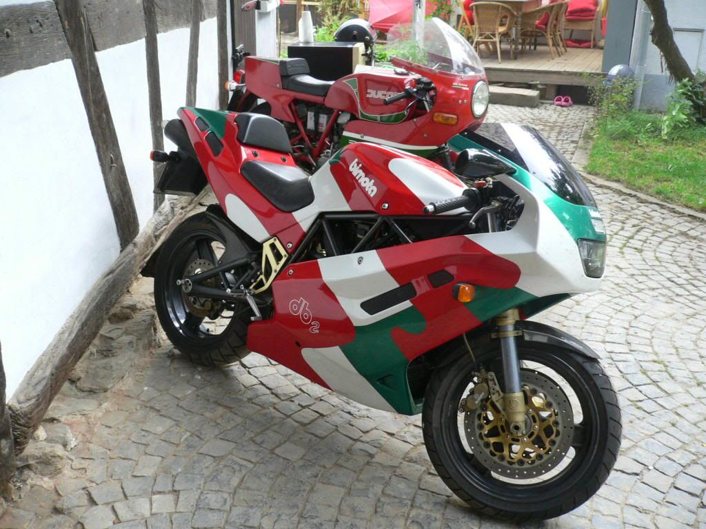

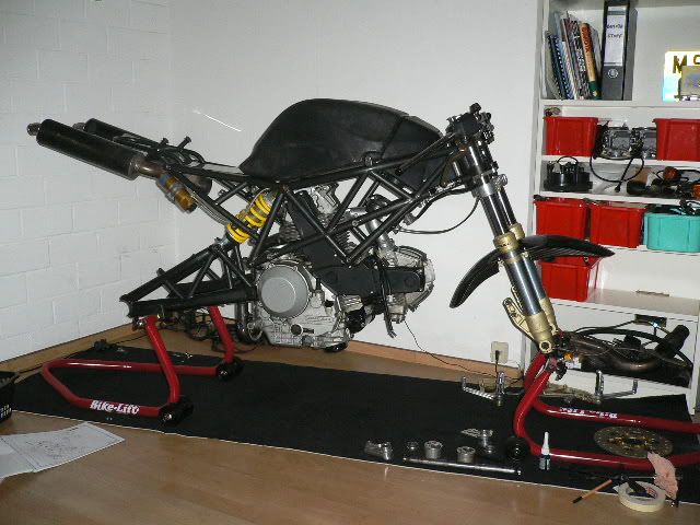

But decided it needs a proper going over anyway, which led to a 2 year rebuild. For which I got a couple of mates to carry it up the stairs to my 1st floor flat where I was living. Mostly it just needed a good clean up and polish, but I also changed as much as possible back to original and touched up some cracks and chips in the paintwork. The paintwork by the way is gorgeous in the sunshine: red with a gold metallic and metallic green.
My bike also had some differences to other tricos that I haven't seen on any other one:
gold anodized peg hangers and rear brake disc holder, which a previous owner has surely done.
Bimota logo on the tank is white, without a pink gradation.
No 'powered by Ducati' logo on the fairing. And I'm very sure it hasn't been repainted because everything else about it is typical Bimota.

and without bothering to drag it down the stairs again, Sunday morning, window open, plastic bag on the carpet just in case; and yes it's running on one- note slightly confused look.
Turned out to be a short between the pick ups and the ignition boxes, finally!

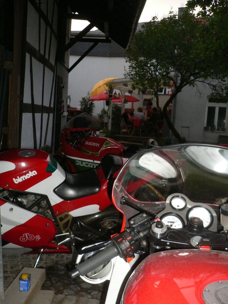

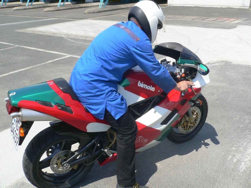

here's the Tüv (MOT) inspecter getting his chance for a quick spin around the test ground, before it's back to the registery office for a permanent number plate. That's a 6 day short term plate which anyone can buy and stick on anything- it includes insurance and tax. Excellent if you want to drive down town in a jumbo jet.
and take it for it's first spin up to local biker meeting point on the nearby Feldberg mountain (800 meters- sort of mountain).

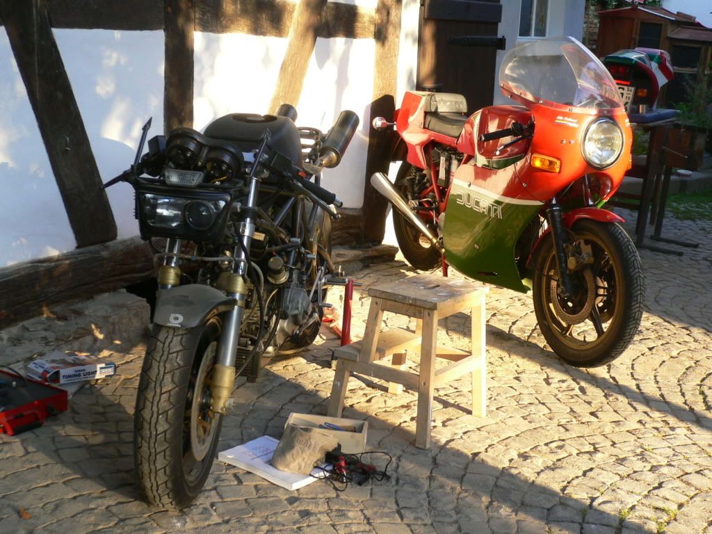

last August, just checking the ignition again before John, Howard and Andrew turn up.
all back together again, only to have the clutch slave cylinder let go on the way back from Schotten, CNC part now fitted.

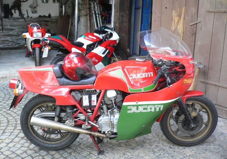

a couple more pics from the weekend with the yard full of toys and their riders, lovely.
You don't suppose I've got something about red white and green do you?
