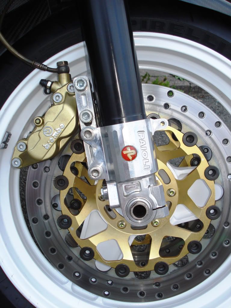

Does anyone know the minimum disc thickness on the SB6 rotors? I can't see anything stamped on the carrier except for 5D on one and 5DD on the other. |

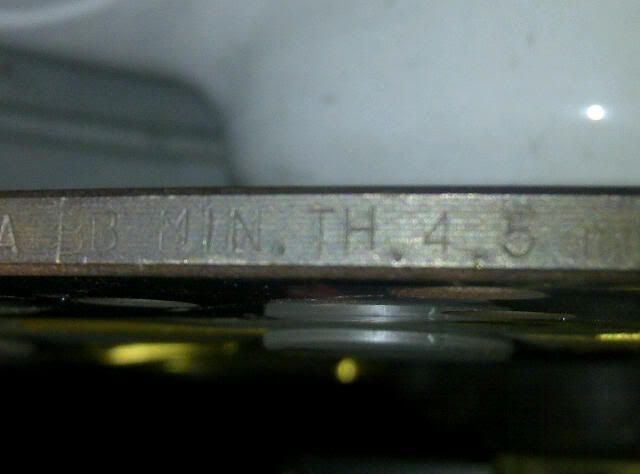

New thickness is 5mm for the full floater cast iron jobbies with 4.5mm being the minimum thinkness, which is usually stamped on the lip/outer edge of the disc itself, usually difficult to see, you need good light and look carefully. |

Do you have the standard rotors and carriers on your bike? Cast iron discs would be thicker and SS are normally thinner, some carriers have it stamped on as below on my Ducati that has fixed SS discs, but note these are 3.6mm minimum
whereas my DB2 doesn't have anything stamped on the carriers
When I bought the above discs, from Rudolf of Bimota-parts.de he assured me that 5mm is the new thinkness, and 4.5mm is the minimum thickness, and I trust him in that regard |

Hi CBar, jsut found the pictures of your Sb6, and you have the marchenesi wheels as opposed to Oscom, and your discs are the triangular and circular carrier type, that would be cast iron and 5mm from new, 4.5mm wear limit. You may still be able to buy from brembo, or search ebay for secon hand ones as they were fitted to many ducatis, but mostly the Sp versions, as the cast iron full floaters were considered an upgrade only fitted to the "superior" models that Ducati sold, such models being 748So, some 851's, some 888's and the 916 also. Always worth having a spare set. Vort 28 has a set and could measure/check for wear indicators, as these discs were fitted as standard to the Bimota YB11's |

2bims wrote: |
We have a winner. Thanks to everyone for the replies. I was a little worried because new Brembo's are advertised with 5.5mm thickness new.
Posted: Thu Sep 15, 2011 2:03 pm Post subject: |
2bims wrote: |
isn't that sticker on the wrong side of the wheel ??? _________________ Don't read everything you believe |
