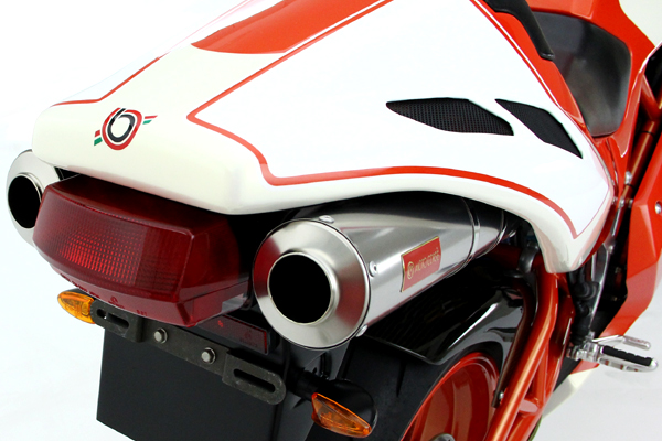

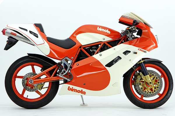

As I said, my vision for this bike was inspired by the 'DB2C' built by Moto Corse as a one-off for a customer. The Marvic wheels are one big difference to the overall appearance and the other was the exhaust system.
I have seen (and heard!) these exhausts on 2Bims DB2 and really like the more 'brutal' appearance they lend the back end.
So after aborted interest from a couple of builders I eventually found someone to make custom cans and 1-2 section in Ti. The fit had to be exact as it mated to the 2-1 OE exhaust section and needed to exit correctly to fit the underseat exhaust cutouts
