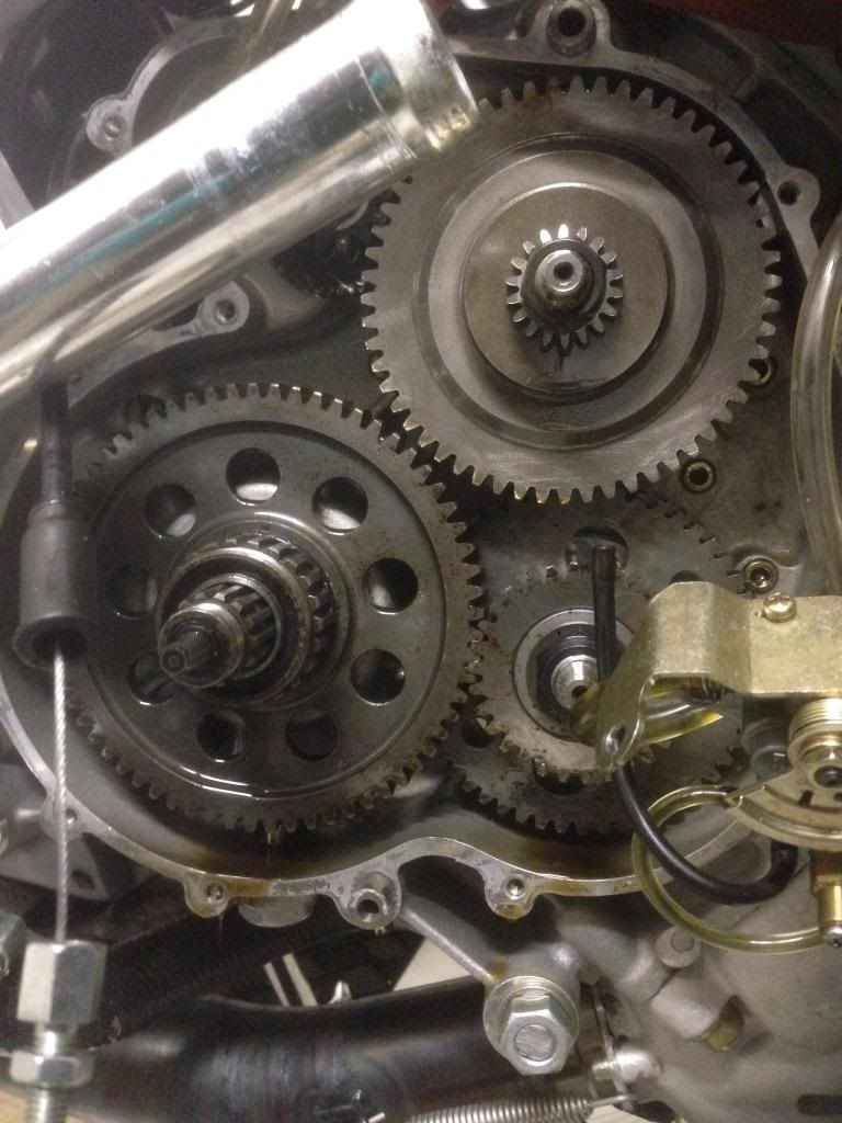

Had to alter the tool I bought to fit the nut.
( drill out 22 mm in the center and weld a socket to it)
mm500
Joined: 18 Feb 2014 Posts: 121 Location: Norway
Posted: Mon Apr 07, 2014 2:25 pm Post subject: |
Had to use a lot of force and heat to get the bolt of !!
mm500
Posted: Mon Apr 07, 2014 2:31 pm Post subject: |
...and the 4 little screws was fastened with loctite as Piero told me...

Posted: Thu Jul 10, 2014 1:21 pm Post subject: |
| mm500 wrote: |
Oh yes, lots of heat, but then to much and you can damage the sealed bearing. Took me ages to get that nut off.
All part of the bonding process. . |
