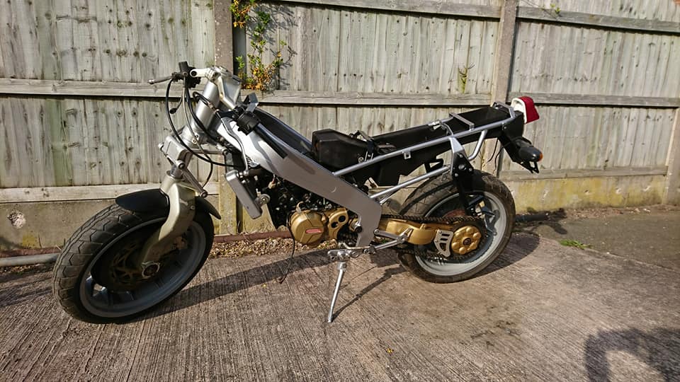

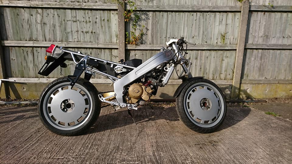

Some might remember the CX rolling chassis at the Manchester bike show last year.
I have had a few plays with it since. I stuck and engine in it, and a few other bits:-
Decided to have a bit more of a play.

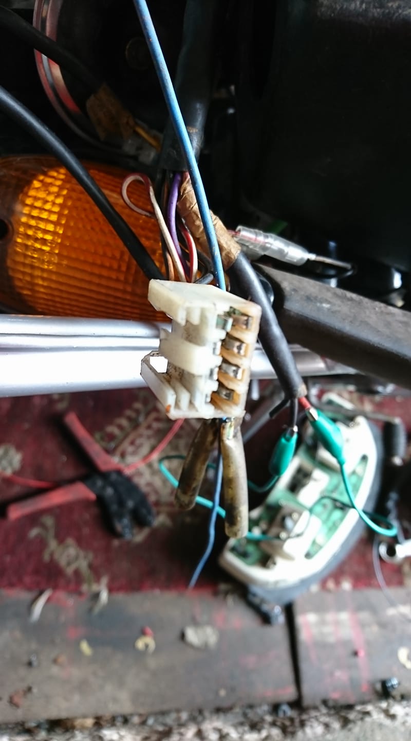

I have put a wiring loom on it. The loom is a bit of a mess having been badly chopped around by a previous owner. Often it seems for no apparent reason (eg, they cut the wires to the regulator / rectifier about 6" from the end, and they are just individual spade connectors so no reason to chop them off). I have had a bit of a session repairing the loom. Now fitted. My aim is to have the dash lights working, and maybe get the bike to start and run. Never going back on the road so not worried about it being reliable to ride.
I do have a better loom, but don't want to waste a good loom on this chassis!
One of the bits cut off was the connectors for the l/h switchgear (replaced with chocolate block connectors). Fortunately they used standard Molex connectors so relatively easily sourced.
Connected a battery up crudely and with a bit of fiddling most of the dashboard lights came on. Petrol level light turns on / off when that sensor is shorted out / not shorted out. Same for the oil warning level.
Connectors to the dashboard are a bit dodgy and not sure where to source those from.
However the rear right hand indicator wouldn't work. Turns out to be a broken wire in the loom. Ordered some wire of the right colour and will solder that in, then tape the loom up again.
Also had a session bleeding the front brake through. This was stripped and painted for the show last year, but I never put any fluid in it. Fluid now added and it works. Bit of a pain to do the brakes. The fluid reservoir is tiny, and you can barely get at the caliper with the wheel in place (you cannot remove the caliper without removing the front wheel first). But at least having a working brake makes it easier to stop when pushing it around.
I do need to sort out the front bracket that hold the clocks. I have this chassis plus another (which will go back on the road) and I have 3 spare brackets for the clocks, but all 3 are a mess (one very badly welded when repaired, and 2 bent, one very badly and the other which seems to want to brake rather than bend back to shape). Might speak to the guy who welded a couple of brackets on the frame last year and see what he can do.
Getting there.
Katy
