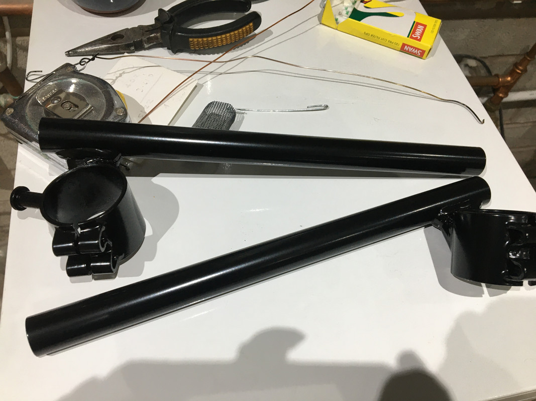

The clip-ons turned out really well. Look spot on. Didn't know it could be done at home. Is it much of a hassle?

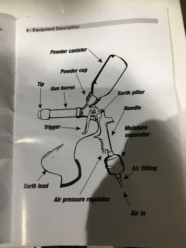

No hassle at all. You can buy a powder coating kit, all you need is a compressor ( small one ) follow the instructions to the letter, max 50psi through the gun. You can buy every colour going. Pinch the wife’s oven or in my case pick one up for £20 off evil bay or market place.
I’ll find the manufacturer for you and post it on here, UK company cost about £125.00 when I bought mine quite a while ago though.
Keep the powder as dry as possible, so keep it in a warm room, best to use an old cupboard to spray in, keeps the mess to a minimum and you get to re claim any spilt powder.
