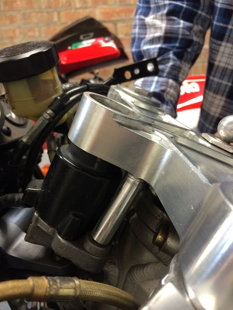

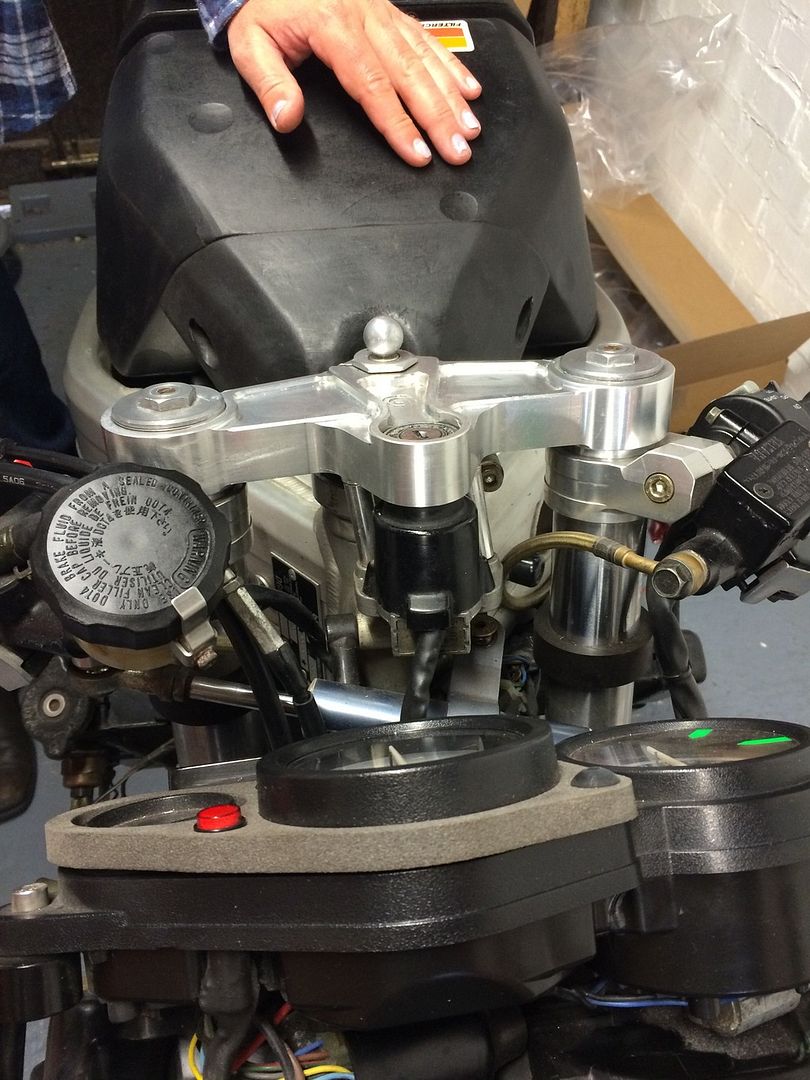

Thanks for the info , turns out getting the bike running right is now no longer my main concern.
Upon inspection I have discovered that the front wheel is out of alignment with the yokes. Top yoke set straight shows front wheel pointing 10 degrees.

It's done about 17000km , well that's what the clocks say.
Looks like I'm gonna have to go through everything looks to me like it's and a low speed crash.
Tell tale signs
Look at the aluminium posts that hold the ignition barrel.
Maybe it has been dropped with the steering lock on?

Hello Jim, you may well be right about it being dropped with the steering lock on, given the very short side stand and it being self-retracting. Hopefully, loosening everything off will see it drop back into alignment.

Just a point about the fork alignment. Have not seen that particular style of fork, but there is a chance that one that looks like it is sitting higher than the other is because the spring pre-loads are not equal. The preloads on the earlier bikes raises or lowers that section. There is a chance, that if you put a 6 point (not 12) socket onto the hex part of the fork cap, that it will wind in to an acceptable position. Dunno for sure,but worth a look, comments?
