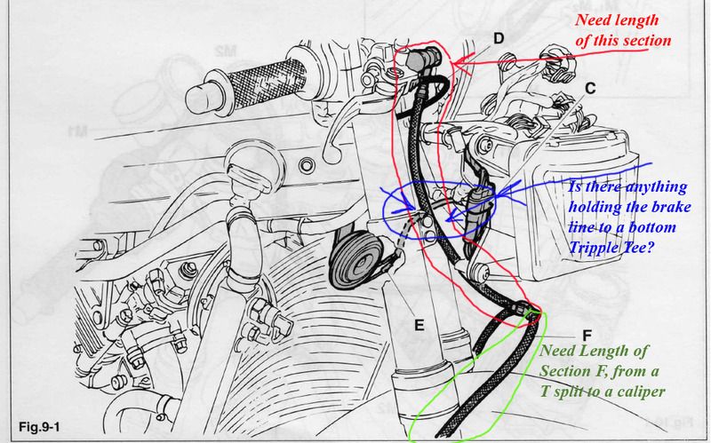

Still need help with some measurements. If anyone has stock setup could you please measure the lengths of marked parts
Thank you in advance

PostPosted: Thu Apr 30, 2015 3:04 pm    Post subject: Reply with quote
Length of standard fit bimota front brake lines (from centre of banjo bolt):
Top line 350mm
Both bottom lines 460mm
There is no fixing to the triple clamp or fork tube, the whole assembly sits in front of the headstock.
.....if someone explains how to do it I'll post a photo of the setup.

PostPosted: Thu May 28, 2015 8:03 am    Post subject: Reply with quote
Top line 350mm
Tlmania, thank you very much. That what I was looking for

Posts: 7292
PostPosted: Wed Jun 17, 2015 5:19 pm    Post subject: Reply with quote
What happens when you turn the wheel all the way to the left? does the LHS switchgear and your thumb easily clear from hitting the tank/frame?....And the same on the RHS when turning all the way to the right...In which case you can slacken off the clip-ons and move then slightly back towards yourself so that the clutch master line clears the instrument cluster??
Always a fine line with any bike clearance on lock to lock between hitting instruments or the clocks or the tank.
Alternatively....as the left side switchgear should be held captive with a drilled hole in the clip on bar...you could slacken the clip on bar from its clip on and turn one way or the other so it doesnt hit the clocks???

PostPosted: Thu Jun 18, 2015 6:55 am    Post subject: Reply with quote
I know that but it looks that a previous owner replaced OEM braided lines with some crappy aftermarket rubber lines and possibly installed / chose lines with incorrect end fitting on the clutch side. That's why I am asking for help/pics

PostPosted: Sun Jun 21, 2015 3:18 am    Post subject: Reply with quote
Falcolion wrote:
I need to see the bend angle of this fitting.
It is about 15 degrees

Who, thank you very much. That is what I was looking for! I appreciate you posting a comprehensive brake rotor list. I already got that. I also found out that it should be no problem fitting any of these rotors and installing metal bolts in those disks as on the original disks. Even though there are only 10 bobins on stainless steel rotors and not 12 as on the original metal rotors, speedo will work just fine. From what I was explained it works on the principal of braking magnetic field and it doesn't matter if the distances are bit smaller as long as there are same number of bolts n the rotors.
So, I will be installing rotors from my spare Aprilia Falco or Benelli Tornado wheels
I am working on getting this bike fully road worthy. For some strange reason the brake lines are not braided and are regular rubber lines. I also think that when these were installed the clutch side was tightened up under the wrong angle. So, I am ordering new braided lines and should have itr ready for the ride shortly.
Another question I have is in regards to the bar ends. Do the original bars have removable bar ends? It seems, at least on mine. that they are not removable. If anyone one know please chime in. I would like to install better looking and heavier bar ends.
Thanks for everyone's help
