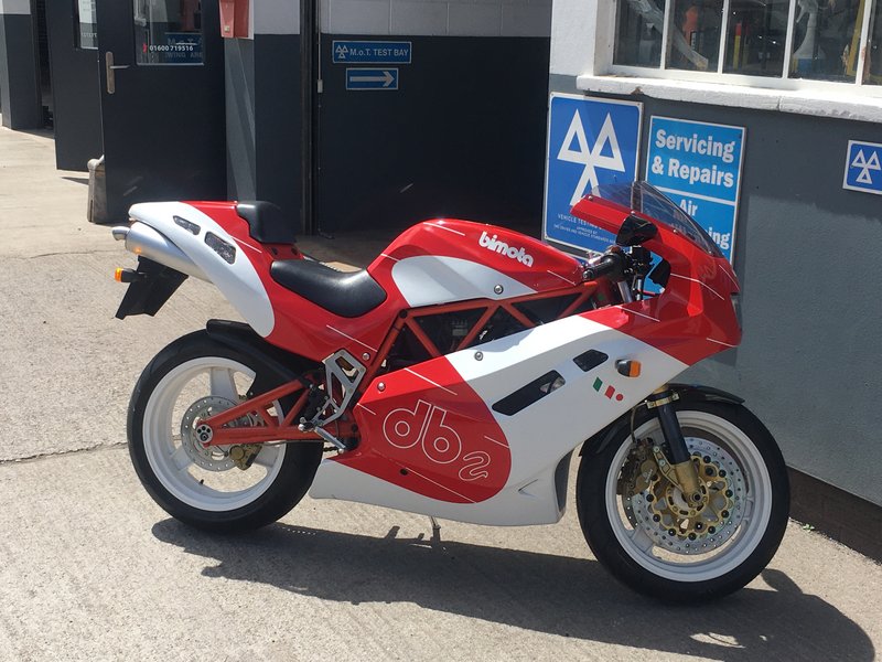

PostPosted: Thu Jul 07, 2022 10:34 am    Post subject: Getting close! Reply with quote
Hooray!
Finally got the bike to MOT Test Centre yesterday (Insured using frame no) and picked her up this morning
PASSED with no Advisories!
Its been a long road.
Bought in Japan mid 2018 It is an early model Bimota DB2 (s/n ****72), with fake ‘twin stoplight’ rear light lens. but first registered in Japan as new in March 1996? 13,860 Kms (approx. 8,700miles)
Finally shipped to me in UK Mid 2019 (don't ask!)
Full recommissioning (covid, house maitenance and other bike projects on TOP of the usual bike resto delays!)
Due to delay in shipping the bike was futher deteriorated by the time I got it and has needed a lot of work to get it to what I regard as a acceptable standard. she's not a 'show queen' as they say but a good useable bike in totally original spec and A1 mechanical condition.
NEW PARTS FITTED
• Clutch master Cylinder lever assy, incl lever
• Reservoir cap on Brake Master cyl assy
• 520 chain
• Front wheel bearings
• Pair of Michelin 2CT tyres
• Brake pads front and rear
• Oil and Oil Filter, brake and clutch fluids
• New fuel lines and filter
• Cam belts
• Throttle cables
• Yuasa YTX14AHL battery
• Heavy duty earth and starter (2X) cables
• Rear brake master cylinder
• OE clutch cover
OTHER WORK
o Front wheel stripped to bare metal and recoated (rear is clean and
original)
o Sidestand stripped and re chromed better than new (triple plated)
o Rear axle/eccentric pins stripped and re chromed better than new
o Brake discs cleaned/refurbished and zinc plated as per new
o Exhaust cleaned , fitted new gaskets and brass cylinder nuts
o Replaced Speedo (now Mph)
o Replaced Front cylinder valve /cam covers with good used (old ones
were suffering from road debris blast)
o Rear hub inspected, Rubbers and drive pins all OK
o Many new fasteners in SS and yellow zinc plated
o Carbs professionally stripped, cleaned (ultrasonic) and rebuilt
with all new gaskets
o Air filter box cleaned and new filter materia
o Carbs set-up on rolling road
Now it has its MOT I need to get all the paperwork off to DVLA to get a UK reg plate on it.
Even on the run to and from the MOT centre it reminded me just how light the bike is, how punchy the motor is, great exhaust note and really sharp brakes.
Will put a few more miles on it just to be sure that everything is settled in but probably will offer it for sale here once registered as I have another DB2 under restoration/rebuild at the moment and thats scheduled to be the 'keeper' ........ I need to convince the wife I am not intent on becoming a trader when she opens the garage door!

PostPosted: Thu Jul 07, 2022 2:08 pm    Post subject: Reply with quote
Well done Ralph, looks great
