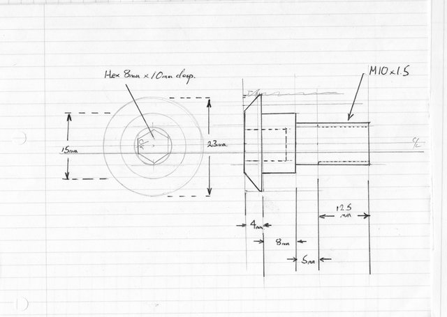

Posted: Mon Jun 29, 2020 2:57 pm Post subject: |
Hi, Im a couple of days behind on this due to other work at the moment around the house! Will post up a dimensioned drawing for you to check. In any case I’ll have to get a quote for a reduced number as not enough takers for the originally discussed batch size.  _________________ Not as many bikes as I would like and already too many to keep up with! |

Posted: Wed Jul 01, 2020 12:48 pm Post subject: |
welshlamb wrote: |
Hi, Im a couple of days behind on this due to other work at the moment around the house! Will post up a dimensioned drawing for you to check. |
here you go Jaguar. (Nb there will be a 1mm 'band' at the base of the screw's head ie the taper isnt the full 4mm depth if that makes sense) _________________ Not as many bikes as I would like and already too many to keep up with! |
