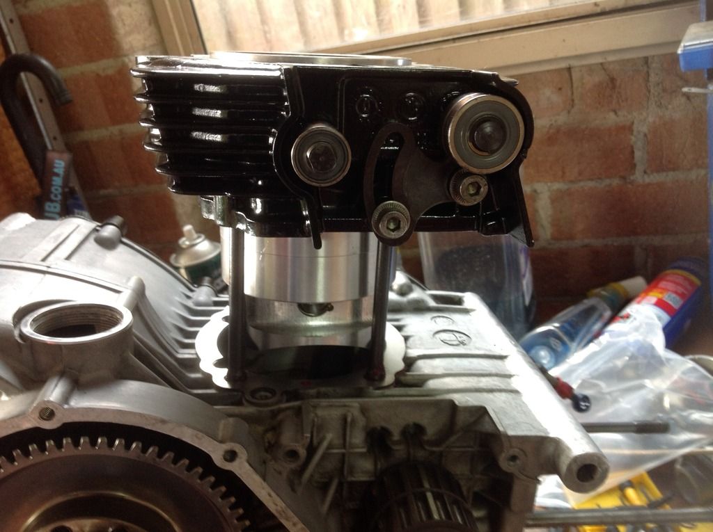

PostPosted: Sat Oct 29, 2016 3:15 am    Post subject: Reply with quote
Thanks guys,
The motor is 1990 go figure .

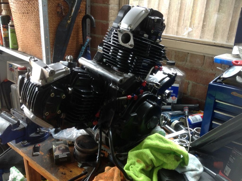

Now the Pistons are in and she's all buttoned up.
Have ordered a complete clutch, sure flex from Ian Gowanloch.
Should be here next week.
Now to remove the other engine cover and get the covers painted.
I will refit them when the motor is in the frame.

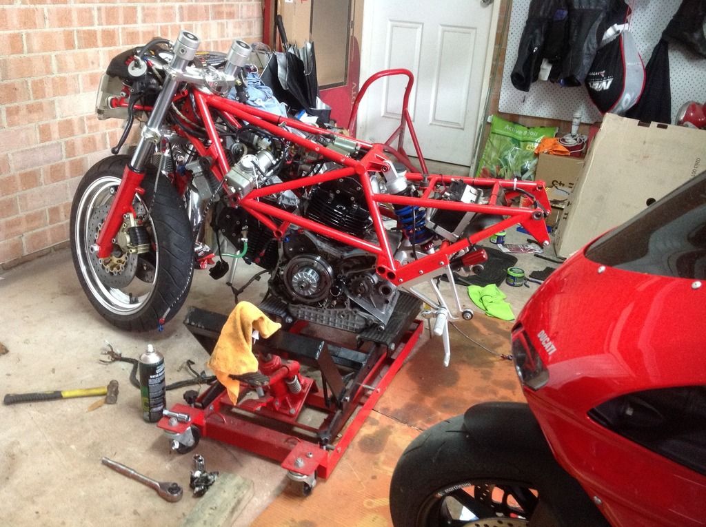

PostPosted: Sat Oct 29, 2016 8:12 am    Post subject: Reply with quote
Motor is now back wher e it belongs.
Will paint covers while I wait for the new clutch.
Now to get the swingarm in and start refitting everything.
A good days work and a few steps closer to being back on the road.

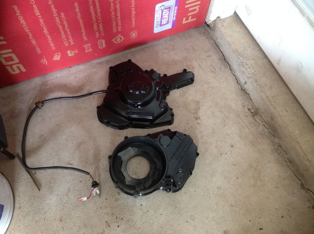

kenmoore
Joined: 22 Apr 2016
Posts: 159
PostPosted: Sun Oct 30, 2016 2:41 am    Post subject: Reply with quote
Mud Flap made and cases painted.

PostPosted: Sun Oct 30, 2016 11:32 am    Post subject: Reply with quote
I know you can't see the engine with the bodywork on but I would know that it was shabby.
With everything that has been done it deserves a tart up.
Best to do it while everything is accessible.

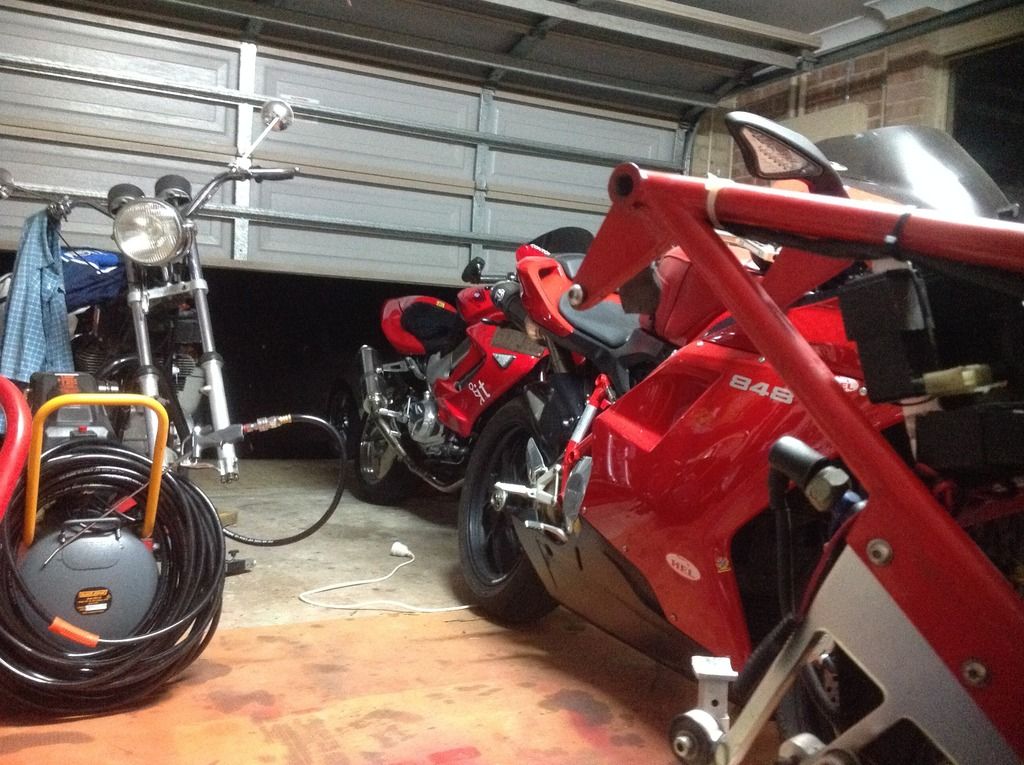

Just have to get it all back together. I have a few bits turning up for another bike in the Man Cave as well. I's my daily rider and needs some attention.
Here is a pic, the daily rider is the one closest to the door.
Can you guess what it is?

PostPosted: Sun Oct 30, 2016 7:13 pm    Post subject: Reply with quote
Your doing a fab job on the db1, definitely worth all the hard work.
Bike by the door looks like a honda firestorm.

PostPosted: Sun Oct 30, 2016 8:26 pm    Post subject: Reply with quote
Waggy,
You would be correct !

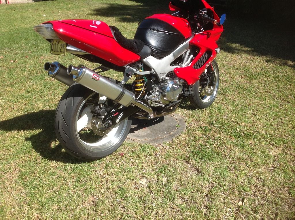

PostPosted: Sun Nov 06, 2016 11:16 am    Post subject: Reply with quote
Waiting , Waiting , Waiting !
Need the clutch to continue with the reassembley.
Fitted some new cans to the Storm.
Sorry if I offend anyone on here but I am going to commit sacrilege and post a picture of , Dare I say it, a Honda.
You can't beat a V TWIN!
Will post pics when the Clutch turns up.
