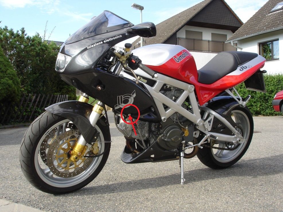

we are looking for more information about the stirrup that supports the fairing in the point shown in the picture. Is a Bimota DB4 ie
Please, someone can send us some pictures about this spare parts?

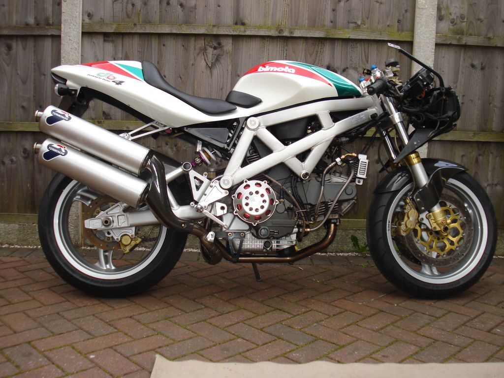

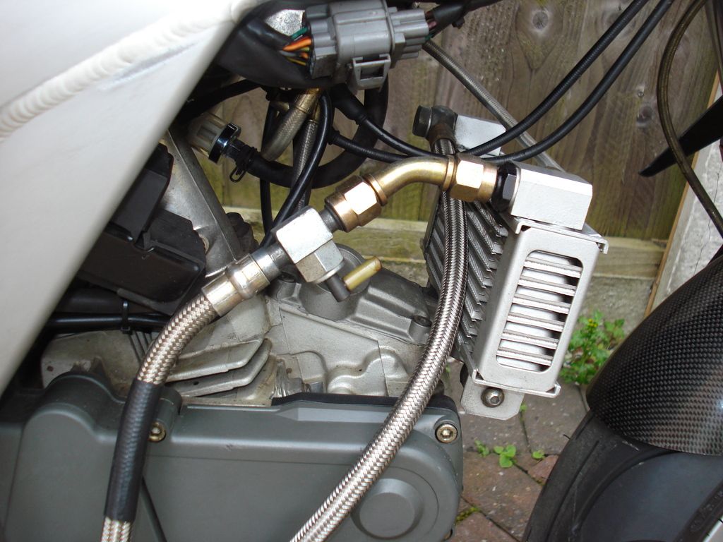

Tricky one that Paolo....not sure that anyone on here has a half fairing DB4.....they are farely rare as are DB4's in themselves as Bimota went bump when this bike was new and not all of them were completed.....below are pictures of my full faired DB4 tri-color...and the front nose fixing point is right where the Oil cooler radiator sits on the one-off valve cover with the brackets built in to hold the oil cooler...so I imagine that a flat plate bracket is fitted inbetween them with a hole for a rubber wellnut or captive nut to take the bolt on the nose cone in that location....wouldnt be too difficult to fabricate one...
Obviously pictures are of the other side...but both sides are same...
