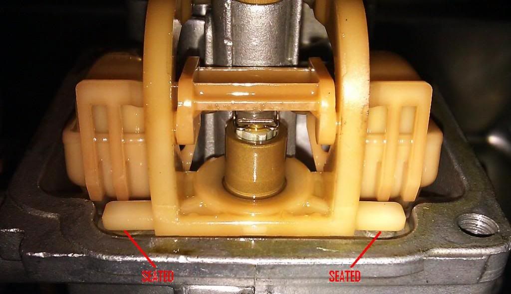

Thanks Vince. The plastic assembly that holds the float is held in place by the float bowl. I'm guessing that i need to hold it down tight with mt finger to get an acurate measurement... yes?
Hi Brian,
You only push it lightly down when the plastic assy is loose from the carb body.
See pic.
After that measure the height
Inspect the o-rings that hold the plastic assy in place, or renew them its not that expensive and I guess they are more than ten years old. In my case they were really bad.
The question is, is it important that the fuel level is correct…. Yes ….
Fuel level too high is too rich, level too low is too lean.
